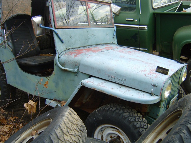

I had a few willys they were great jeeps!!! I still wish I never got rid of the 47 my buddy has the 56 still plows with it[img]Started on the Homelite Jeep_010[/img]
[img]Started on the Homelite Willys10[/img]
Heres what he did to it!!!!!!!!
[img]Started on the Homelite Jeep_b10[/img]

Whats the first one? Don't think I've seen a top like that.

Is that a 3?
Started on the Homelite Empty
PostSubject: Re: Started on the Homelite   Started on the Homelite Icon_minitimeFri 14 May 2010, 12:04 am
the first and 3rd are the same jeep back then willys didn't make a hard roof this one was made by a local company in Waltham Massachusetts.
PostSubject: Re: Started on the Homelite   Started on the Homelite Icon_minitimeFri 14 May 2010, 12:06 am
JD wrote:
Is that a 3?
Yep 56 CJ3
